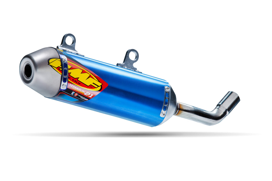

  • 150er TPI :
    All Products
    Shop official FMF Racing dirt bike & ATV mufflers and exhaust parts, exclusive apparel, t-shirts, hats, goggles, and sunglasses here. Proudly made in USA. Free…
    www.fmfracing.com

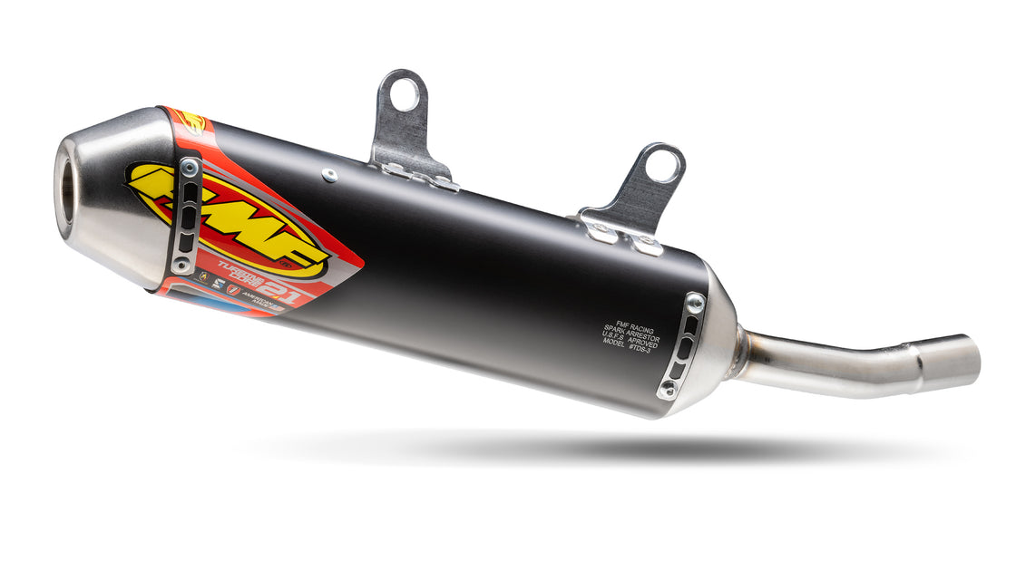

    150/125 SX Vergaser 2022 :
    All Products
    www.fmfracing.com
    Die Nummern sind unterschiedlich.
