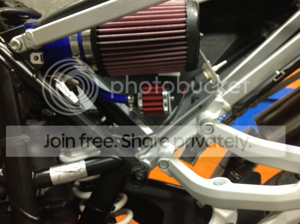

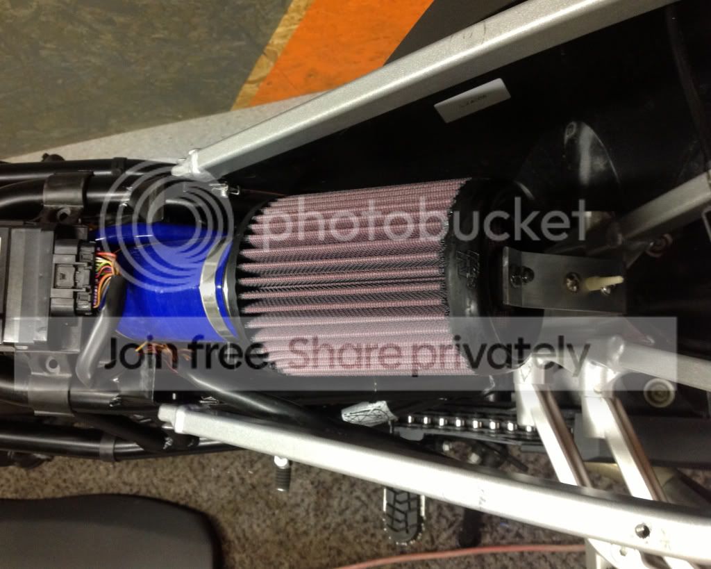

  • Hi there,
    I think its time to introduce myself,cause i am following this thread for a wile now.
    My name is Timmy 29years young,and i am running a ktm 690 sm prestige 2007,stock exept for the akra slip ons.
    I have found another way to modify the air compartement of the sm,
    First i did remove the whole stock airbox.
    I have used the k&n rx 3820 instead of the RU,because i have verry good results with the rx on my crf450r sm.
    For the air inlet i have used a samco hose 60mm bore 45degree and cut that in half,so i had a bend of 22 degree,
    This wil put the airfilter in perfect position and there is no need to cut anything.
    Than i have made a alu bracket,for positioning the airsensor and breather filter,next week the bike will go on the dyno with
    the pcv.
    Hope i have given you guys some good ideas.
  • That´s looking really fine what you did so far :Daumen hoch:
    I assume you can hear the engine "breath" quite well now:grins:
    Can you give me a link where I can order the breahter filter for the the motor housing?
    [color=#ff6600]MoGG #94 Es ist nie zu spät für eine glückliche Kindheit :grins::wheelie:
  • @ mx maniac....http://www.knfilters.com/search/product.aspx?Prod=RU-3230. Just a simple little k&n filter,used as a breather.
    Thanks for the comment,i have post the pictures just for example use on a 690 sm.

  • ... einzigstes , aber gravierendes Problem beim Silikonschlauch ist die Befestigung auf dem doch sehr kurzen Flansch der Einspritzung . Ich habe keine wirklich haltbare Verbindung herstellen können ... Schon beim anziehen der Schelle flutscht das Ding wieder runter .
  • ... hmm ... iss da was anders bei der SM ? Hatte unterschiedliche Schellen getestet , Nuten von innen in den Schlauch gefräßt usw ... nix zu machen .
    Wenner mal drauf war , war er nach spätestens 10 km wieder runter . War der "normale" 60er Samco ...
